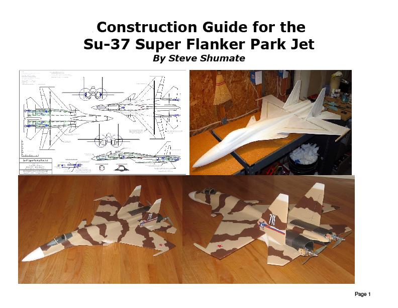

Hola amigos alguien me puede indicar que motorizacion seria buena para este avion que estoy construllendo:
os dejo las recomendaciones:
Specifications
Wing area: 290 sq in
Span: 30.0”
Length: 36.3”
Weight RTF: 22 to 29 oz
Wing loading: 11 to 14 oz/sq ft
Flight controls: Tailerons, rudder (optional), thrust vectoring (optional)
Recommended equipment:
Motor: Two Littlescreamers Park Jet (LSPJ)
Battery: One Thunder Power 2100 mAh 11.1V Prolite
Prop: APC 6x4 regular and pusher (counter-rotating props)
Speed control: Two Castle Creations Thunderbird 18 or Phoenix 25
Receiver: Castle Creations Berg 7P
Servos: Futaba S3110 on all flight controls, Hitec HS-85MG on thrust vectoring
