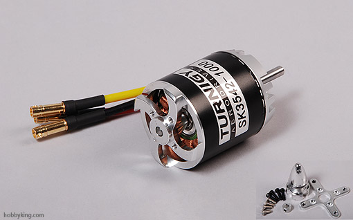

Creo que este motor te ira de perlas:
TURNIGY AerodriveXp SK Series
AerodriveXP SK Series motors are designed for those who want the very best in outrunner technology for their R/C plane. Typically an efficiency improvement of around 8-10% can be seen over similar classed motors. This is in part due to the following;
Stator Laminations: .2mm
Magnet Type: N45SH
Bearings: Dual oversize (Japanese)
Model: SK35-42 1000
Kv: 1000rpm/v
Turns: 5
Resistance: 48
Idle Current: 1.7A
Shaft: 4mm
Weight: 142g
Rated Power: 605w
ESC: 45A
Cell count: 3~4 Lipoly
Suggested Prop: 10*6, 11*5, 13*8
Power equivalent : .15 to .25 glow engine
