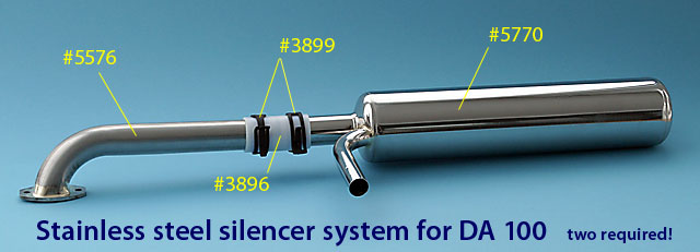

Según he visto en la mayoría de aviones que equipan un DA 100 con canister, los modelos mas empleados son PEFA o Krumseid, pero, alguien lleva montados los escapes que propone Toni Clark. Segun he visto son los Zimerman.
Resulta que yo ya tengo uno, y no se si montar los dos Pefa nuevos o comprar un Zimerman como el de la foto. Lo que me hace dudar es que no veo nadie que los monte.
Este es el escape:
Stainless Steel tuned Silencers and Accessories for DA 100
The DA engines achieve their high power with a tuned silencer system, as is the case with all high performance engines.
The large volume and the compact construction (large volume with small surface area) make these silencer units especially quiet. They are made from thin-wall stainless steel tubing, Laser welded and highly polished. The use of stainless steel throughout makes for an exceedingly robust and lightweight unit.
At approx. 6300 RPM the best tuned length is X = 285 mm. So the best header length for the DA 100 is 220 mm.
Stainless steel silencer DA 100
Without header and fixing materials. Weight 295 g.
1 piece #5770 97,46 EUR
Two are required for the DA 100!
