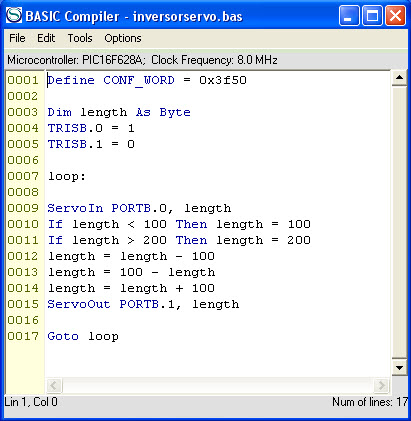

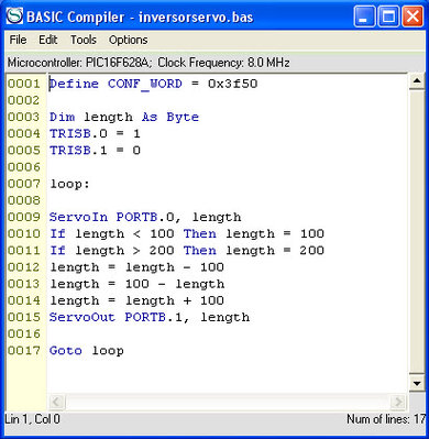

Interfacing Radio Control (R/C) servos
For writing applications to interface R/C servos there are two statements available: SERVOIN and SERVOOUT. R/C servo is controlled by a train of pulses (15-20 pulses per second) whose length define the position of the servo arm. The valid length of pulses is in the range 1-2ms. These two statements have two arguments. The first argument of both statements is the microcontroller pin where the servo signal is received or transmitted. For SERVOIN statement that pin should be previously setup as an input pin and for SERVOOUT statement the pin should be setup for output. The second argument of SERVOIN statement must be a Byte variable where the length of the pulse will be saved. The pulses are measured in 10us units, so it is possible to measure pulses in the range 0.01-2.55ms. The value stored in the variable for normal servos should be in the range 100-200. The second argument of the SERVOOUT statement should be a Byte variable or constant that determines the length of the generated pulse. For proper operation of the target servo SERVOOUT statement should be executed 15-20 times during one second. Here is an example of the servo reverse operation:
Dim length As Byte
TRISB.0 = 1
TRISB.1 = 0
loop:
ServoIn PORTB.0, length
If length < 100 Then length = 100
If length > 200 Then length = 200
length = length - 100
length = 100 - length
length = length + 100
ServoOut PORTB.1, length
Goto loop

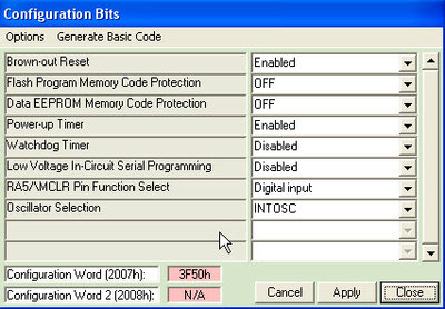

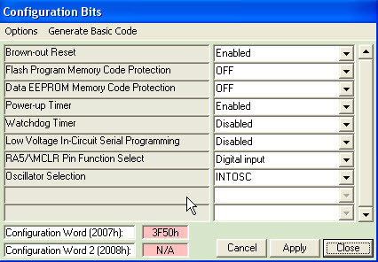

Hola en este ejemplo teneis un inversor de servos, en la puerta B0 meteis la señal del servo a invertir y por la puerta B1 saldra la señal invertida con el pic 16F628A que es pequeño y con oscilador interno
si quereis realizarlo con otro PIC teneis que cambiarlo en el menu principal y ya esta

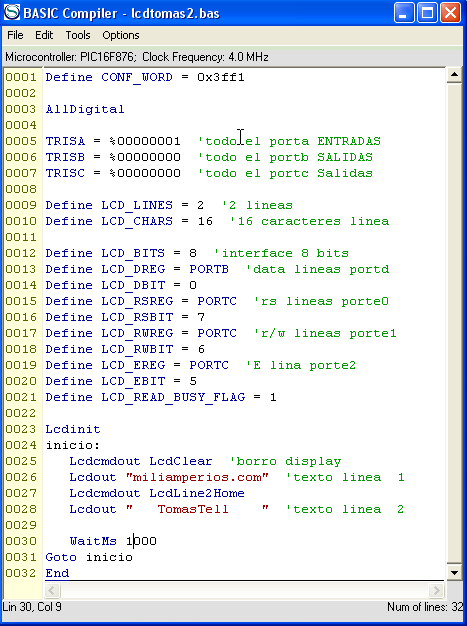

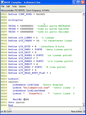

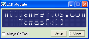

Hola envió un ejemplo en Basic para el Pic simulator Ide de cómo sacar textos en una LCD
Es sencillo solo tenéis que cambiar el testo y ya está lo podéis utilizar para lo que queráis y recordar que si queréis utilizarlo para otro Pic solo ay que cambiarlo en el menú principal
